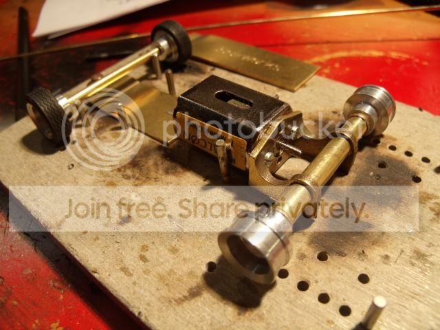

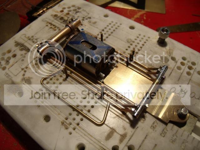

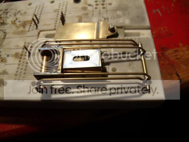

Inspired by the Champion of Chamblee Jaildoor but downsized to 1/32,
making this for my friend Allan Wakefield.

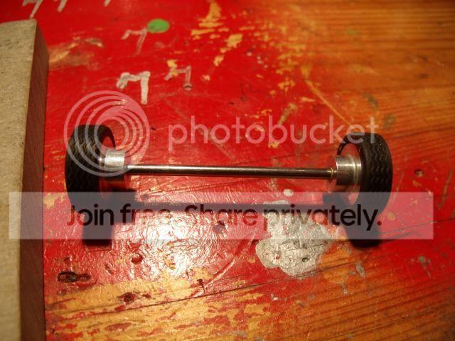

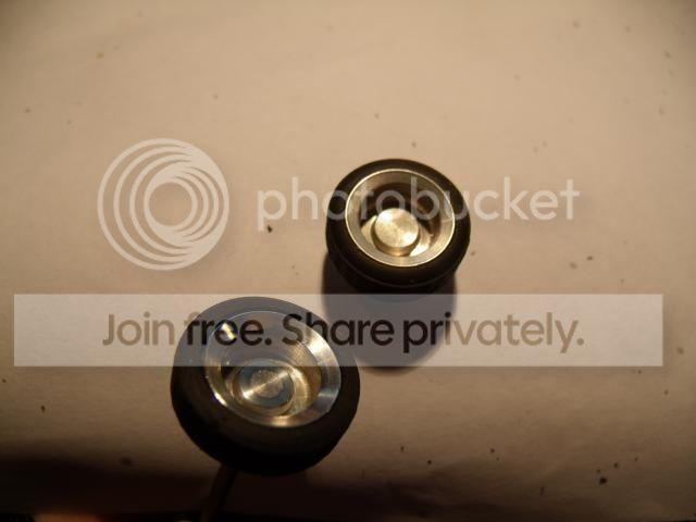

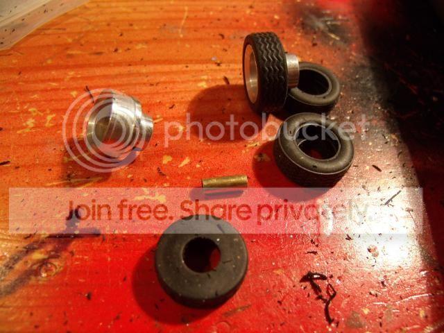

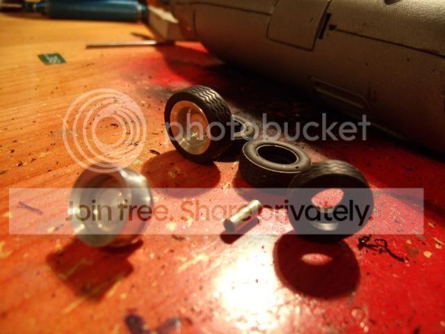

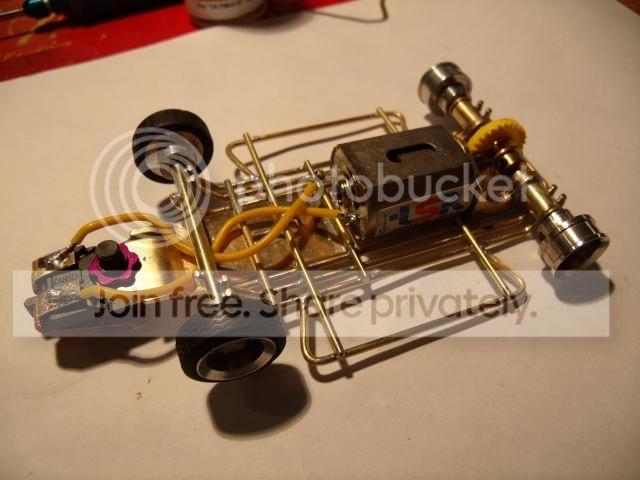

Artin 1/43 rear wheels Dremelled untill it fit on the custom Kai wheels

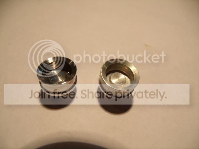

Sleeved the wheels to fit on a 3/32 Axle (Slot It axle)

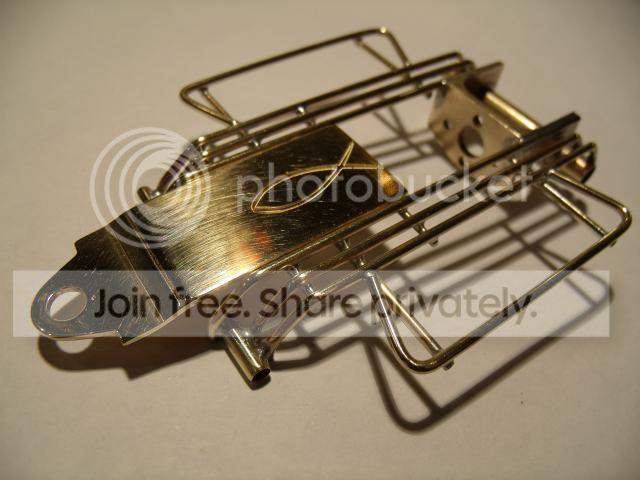

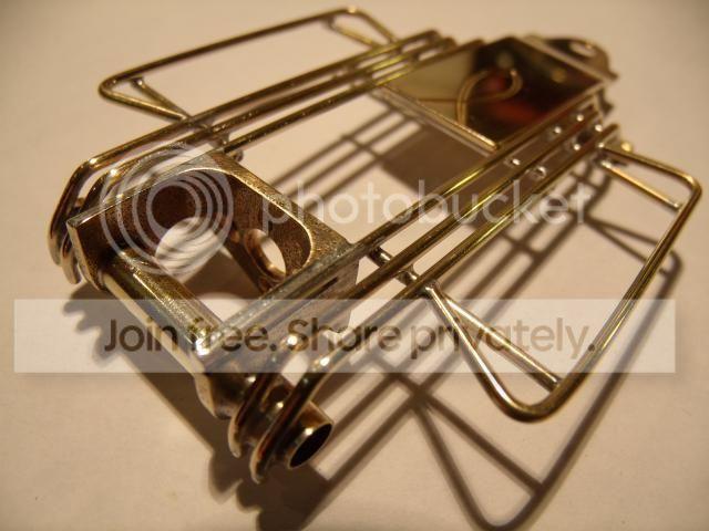

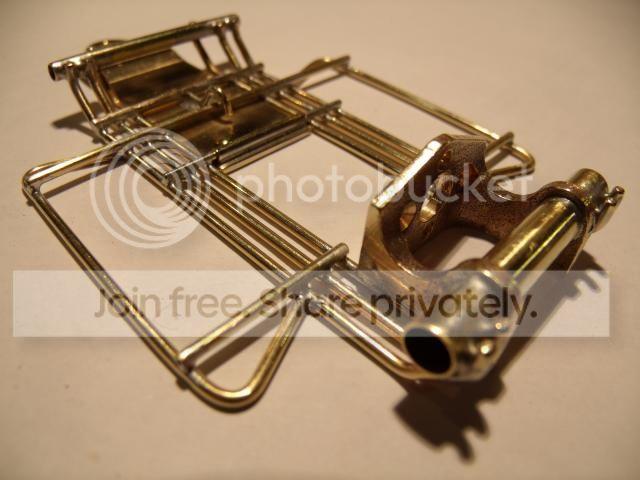

The finished result

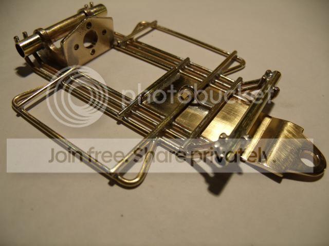

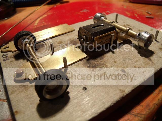

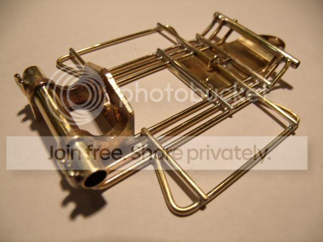

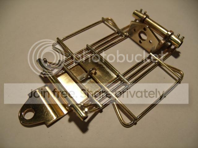

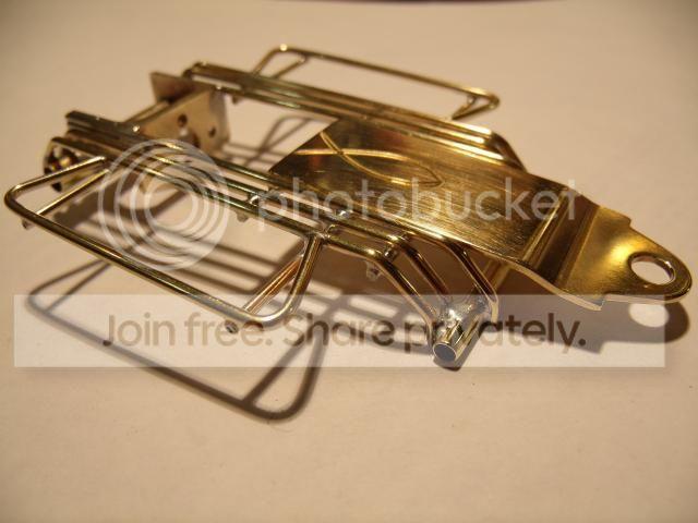

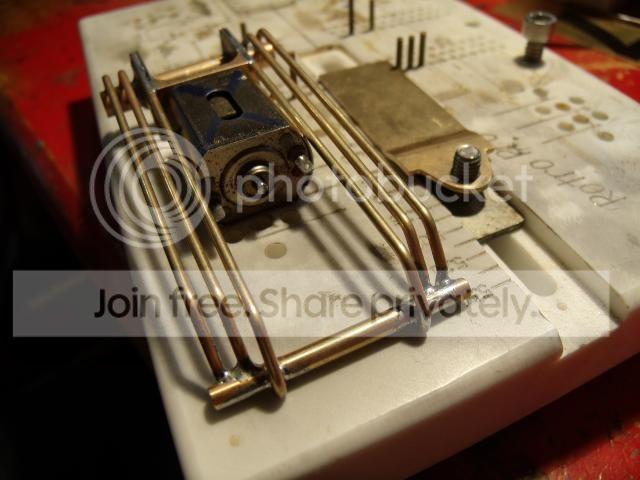

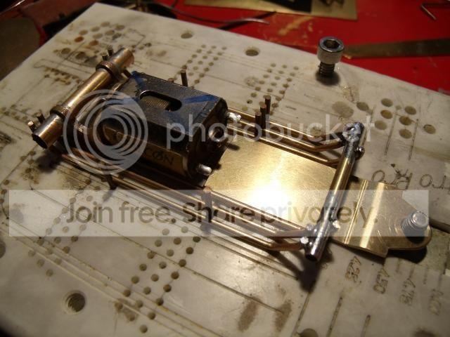

Modified the Sam Stephen Weldon custom Cobra style guide tongue to 1/32 size,

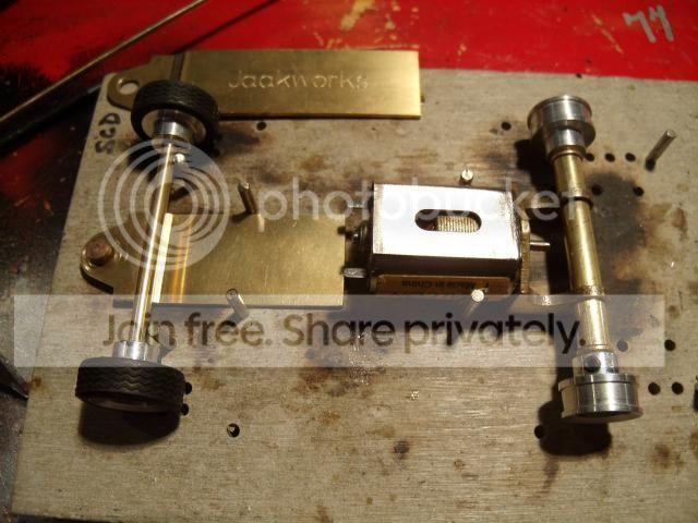

This is a mock up the front axle tube has been shortened a bit after this picture.
Drilled out the Al Penrose (BWA) bracket to fit a tube to match the Champion of Chamblee style.

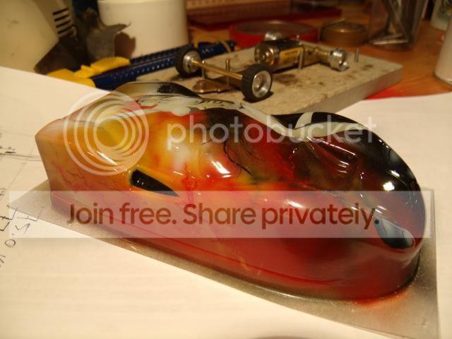

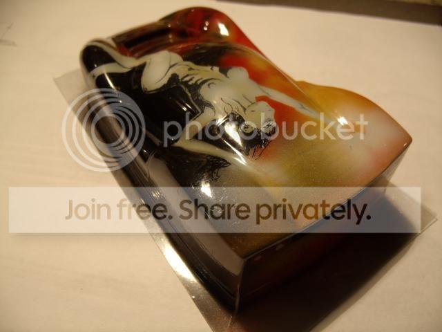

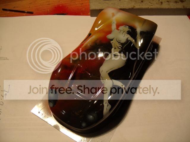

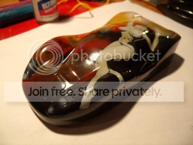

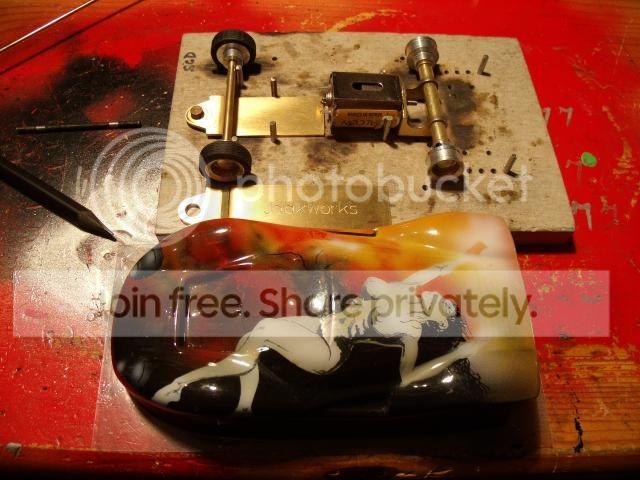

The photo's do not do this body any justice.
The wonderful paintwork is done by Lupo Lupazzi.
The 1/32 Mini Dream body was made by Lucio Cocchi
